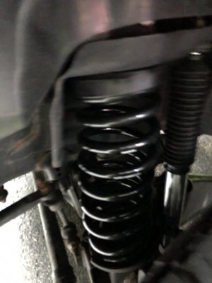

I just did a Bilstein level kit on my 2500.
Scuttlebutt is next 8E4927B7-7218-44F4-84E0-734345B94C86.jpeg year’s models will all have Bilstein’s from the factory.
