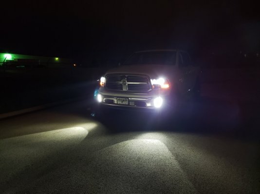

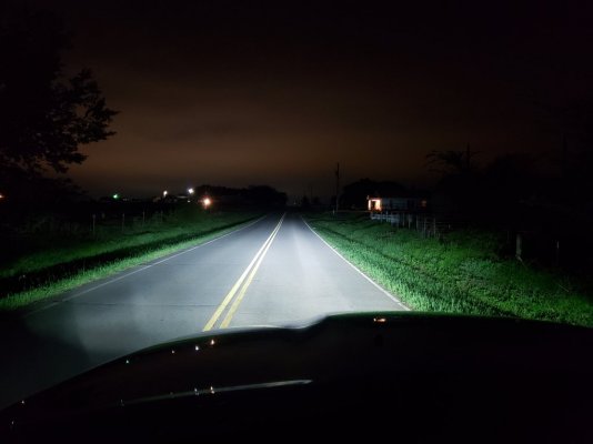

I used Heise LED in my 2019. The headlight housing are clocked correctly, and i had to clock the LED fogs, no biggie. But order the adapter harness, and no flicker, no issues at all.

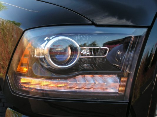

Which headlight capsules do you have? Projector or standard?
Projector:

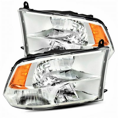

Standard quad:
