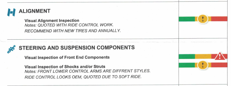

It isn't just bumps, i can be driving, take a slight turn, at lower speeds, even if it's just 10 to 15 degrees angle, it can happen. What it sounds like to me is 2 pieces of metal smashing together, and then sliding off of each other. Could this have anything to do with control arms? This image is from 8-2-2025, this was the report I got back when I had new tires put on my truck. The visit before this was to replace the front control arms that were failing. The kid who did the tires called it out and said it didn't look right. I brought it in a week later, had them look at it, and the response was "It's because one part looks new, and the other isn't". But I have it in writing, if something is wrong, and it's their fault, I'll have them fix it. If that's the case, I probably won't ever return to Les Schwab for anything but tires. The tech who told me that it was because it was new vs old, did some mad smack talking about the kid who did the tires, and I have zero tolerance for colleague abuse.

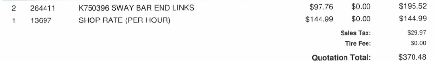

But to stay on topic, you were pretty close in getting it right. The culprit is Sway Bar End Links. The driver side is broken, and that's what I hear occasionally smashing down.
This is what I was quoted for a price to fix it.

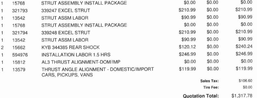

They checked my shocks, struts, etc, and stated that only my left side rear shock is leaking and it isn't THAT bad. This is the quote they gave me to do the struts, and rear shocks.

I looked on rock auto and depending on what you go with you could get a new link for like 10 or 15 bucks, them charging 90 for the part and then a full hour of labor is pretty ridiculous. For that price 100% something I would do myself.
