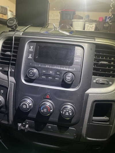

I have a 2014 Ram 1500 tradesman with single zone heating. The issue I am having is that when I turn on the heat in the vehicle I lose almost all airflow from the driver side vents.
I have checked all of the actuators for proper operation and they all seem to function correctly. I have pulled the blower motor to see if the evaporator if clogged and I don’t see any issues there. Does anyone else have a suggestion as to what could be causing this?
I have seen online people recalibrating their dampers using the recirculating button but I have never been able to get this to work properly.
If any one could point me in a new direction I would greatly appreciate it.
