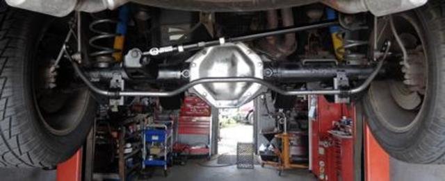

When I lowered my 2010 CC last year I got new Bilsteins same length as OE and 2" drop coils.
No shake or vibration, and tires/axle are still centered in the truck.
I did just upgrade to a Hellwig sway bar & Freedom Offroad 0"-4" adjustable panhard bar,
both items are heavy solid steel compared to the OE hollow tubes they replaced.
The FO panhard would solve your side-to-side issues, the Hellwig would keep the back end planted.
(I'm on the firmest of 3 settings and love it!)
