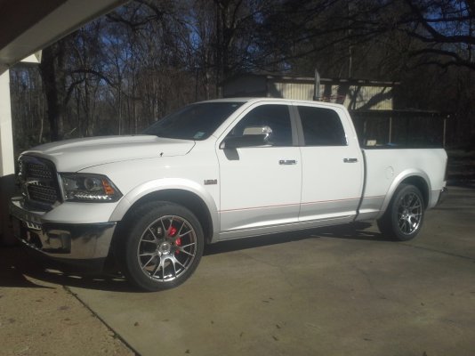

This is a 4x4 lowered 2'' in the rear. Still factory height in the front sitting on 22'' wheels.
You can have the best of both worlds. I used my 4 wheel drive this weekend to get me out of a tough spot.

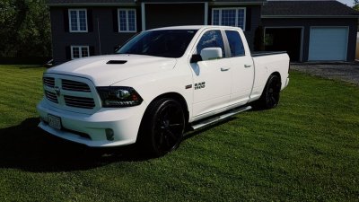

Mine is a 16 with 2" front 4" rear drop.. 4x4 still works, still tons of clearance..... Stock tire size in the winter and 305/45XL24 in the summer which is same OD as stock size..
Do it.

Its groundforce 2" front springs and 4 Belltech rear springs... But since then I believe Belltech has an entire 2/4" kit for 4x4's now so thats the way I'd go if I did it again.

Lowered 2/4 drop Belltech
On 22x12
305/22/45dca0019abbb0564ec86f76a6190663b9.jpg
