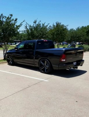

You tell me if its worth it. :) Ive had 6 new body style rams and all of them lowered and ive never had any issues. In my opinion the spohn bars are just for looks. They correct the look of the wheel centering. The track bar just allows you to center the axle from side to side (looks) as long as you get the right lowering kit you will be fine. Now I wouldnt mind ordering me up some sway bars I like to take curves pretty hard...
