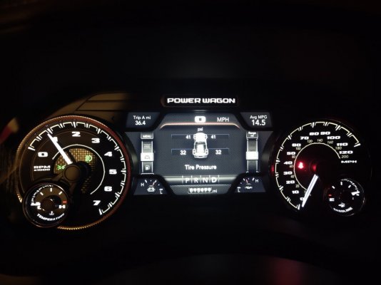

A question is at what point does your low pressure warning come on, I'm not
sure about mine but some vehicles it comes on if you are below 40 psi.
Nov 20, 2018
77
Riverside California
2018 2wd
HEMI 5.7 Revolution 4.88s
Well I changed the thresholds on my truck using ALFAOBD ... but before that I think the warning popped up at 39 psi if I'm not mistaken
I lowered the threshold with AEV procal so down to about 25psi before it kicks on

My low-pressure warning comes on about 75. I would lower the PSI more if I could do it without the warning.
