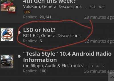

Ramm5.7
Sep 23, 2017
5,322
7,365
So Cal
2019 Ram 1500 Classic Bighorn
I saw this and was like..., uhh no, dont do that kinda serious drug...lol
