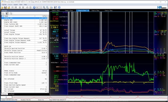

Yes, this was a remote tune. I data-logged (using HPTuners on my laptop) as I drove around, various speeds and loads. This captured specific information (a list which he provided) and allowed him to formulate a trans tune based on all that. For instance, below is a snapshot of the data-log so you can see some of the info that was captured. Pretty much all custom REMOTE tunes will require some sort of data-logging. The tuner can then see what's going on, and make adjustments accordingly.
I actually ended up wasting my money, as I did not like the feel of the tuned shifts, but that was easily reverted back to stock (by me). All I really needed to be happy was higher shifting points, which I could have done myself, oh well.

The best street tunes are done with your tuner sitting in the pass seat,with you driving,any dyno tuner,that also doesn't get in the pass seat with his laptop while you make hits on the street,is a tuner you want to avoid.
Of course a remote tuner doesn't have that option,so he relies on you being able to do the driving and recording datalogs,then sending them to him

Very cool. Seriously granular. It would be nice if the tuner was sitting with me as Wild One suggested, to dial it in further.
Sounds like I just need to get a cable and download the software to create a log file. Easy.
