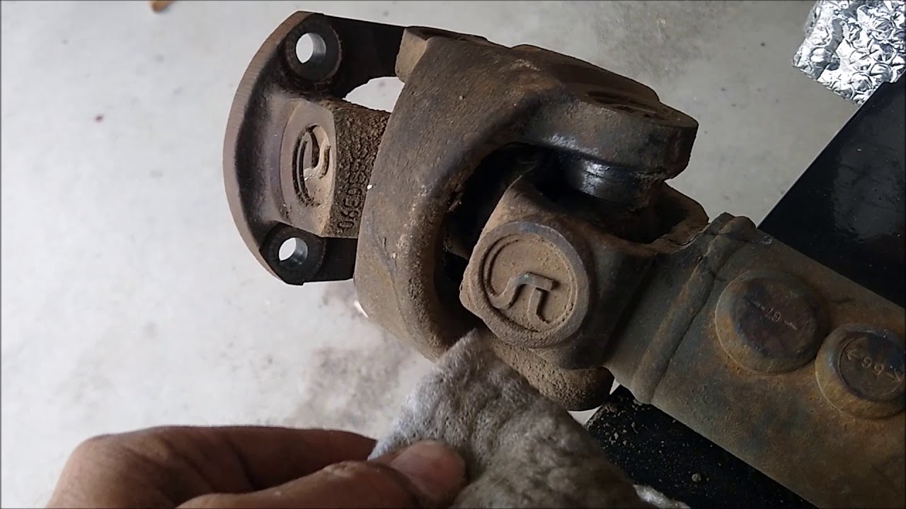

Only the 4 wheel drive Generation 4 Rams have 1 zerk fitting, it is on the front shaft.
It is very difficult to see, it is different from zerks that you normally see
As far as i know,that's only on the 2500 and heavier trucks.
