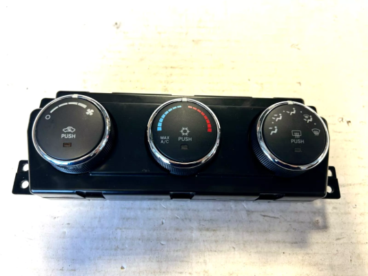

Hello, I have a 2010 2500 5.7. I just replaced the heater core flushed the system before reconnecting the heater core hoses I had hot heat from both sides for about a week now I only have hot heat on the passenger side and it gets Luke warm on the drivers side. I have the single climate control and can't for the life of me figure out what happened.
Does anybody else have this problem? If so did you fix the issue?
Thanks in advance for those who could help me out!

The BLEND Door, is just to the LEFT of the A/C Fan
It is only 1 door, 1 actuator on a single system
this is a DUAL Controls system
notice Up & Down arrows on both sides
2 blend doors & an actuator for each door
The single door system lifts up & drops down
I may be wrong, but i think lifted up, the Air Flow passes over the Heated Coils
Then the Air goes to the 2 MODE Doors
those 2 doors direct the air to the different VENTS
the Mode doors are directly below the radio & A/C control knobs
floor & top of dash
& i believe drivers & passenger side vents
found this
Temperature Blend Air Door Actuators: The temperature blend air door actuator controls the temperature of the air flowing from the vents by mixing hot and cold air from the heater core and the evaporator.
Mode Door Actuators: The mode door actuator controls what vents have air flow, i.e. floor, panel or front, defrost, or any combination of those.
Recirculation Door Actuators: The recirculation door actuator controls the intake of air into the system, either bringing outside air in or using inside air in recirculation.
