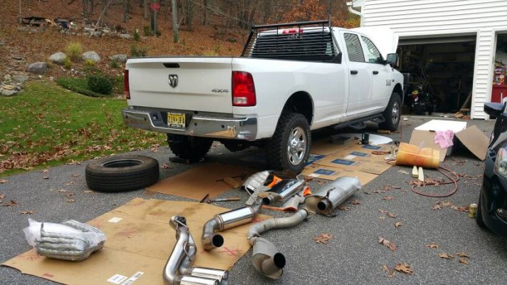

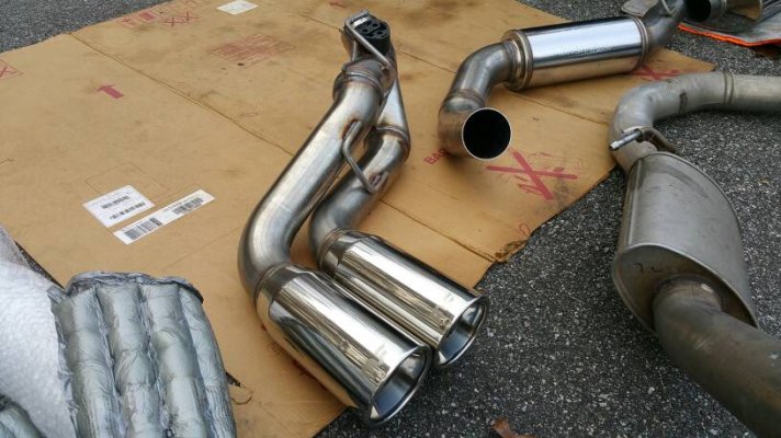

I bought the dual 5" outlet kit from MagnaFlow. Has a 22" muffler and the high flow resonator is part of middle pipe.ff0283ca1d2bcf840adb021dbe77dbb9.jpg528bc48f9e6c119a3210892b0a4f7621.jpg

Yup. Take the spare out. Tried to do it without doing that & wasted 45 minutes.
No need to "cut" anything. Clamps loosen up, old parts come off, new go on.
That is a nice looking system RR...how does it sound? Any drone?
