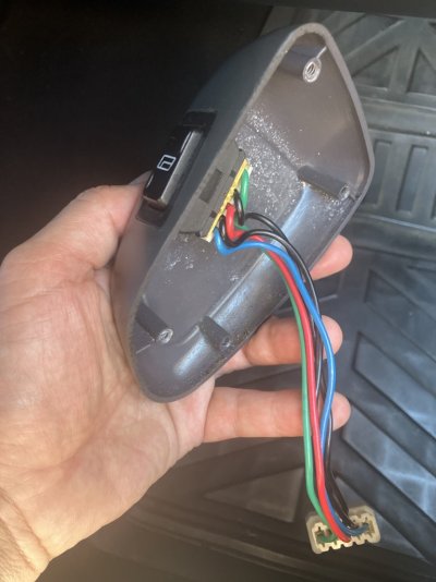

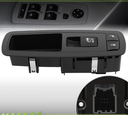

I have aftermarket power windows but I want to use the stock window switches not the aftermarket switches but I don’t know what pin is for what in the factory switch panel. These photos are of passager side
Honestly, I'm not sure how the factory window switches operate (if they are analog up/down or receive a message of the BUS). What year did your switch you want to use come from?

Aftermarket to OEM is not as straight forward and simple as some may think.
In the OEM setup, the switch doesn't control the window. It tells the door module and computer what signal / control to send to the window motor. The motor then sends signals back to the computers via current draw showing it is at it's limits to turn off operating up/down power.
Aftermarket ones are any man's guess unless we know exactly what they are and what controls them.

Damn I was afraid of that. So I would need the door regulators modules and program the ecu right ?
A at a minimum, yes. Programming is not done in the ECM / ECU / PCM. Don't forget the correct wiring harnesses and fuses / circuit breakers, also.
Both the BCM and TIPM will need to be programmed and the appropriate outputs in the TIPM activated.
A job not for the faint of heart.
