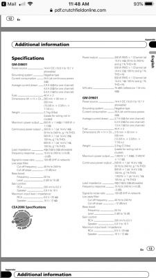

I don’t want to run wiring all the way to the front to get signal for the amp. Ram has done it conviently for me at the stock sub lol. Where do I get those ratings for the high level input? I just checked online and all it says for high level is 16v max. Attached is a screenshot of the 8601 specs.

I’ve never seen max watts for a high level on an amp before. It’s more about voltage from what I’ve seen as they are based on low voltage RCA preamp connections.

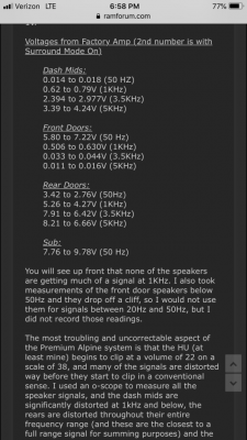

So I did some looking up. A guy tested the voltages at all the speakers and sub via the factory alpine system. Looks like the sub outputs 9ish volts which is within the 16v margin of the pioneer amp. See pick below.
