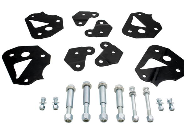

Rear control arm relocation brackets, typically from inez suspension ;
or Check both sets of your lower control arms in the rear. Bushings tend to become sub optimal somewhere between 30 and 100k miles. Typical replacement is core 4x4 or others, Clayton, freedom or even from ebay.
Most do brackets before control arms

If you have sway at highway speeds,you'll want to do the relocation brackets,everything else is a band-aid,and doesn't do anything to correct the rear suspension geometery.When you lower these trucks,the rear suspension goes out of whack,and can actually try to steer the truck when you hit a bump,creating what most guys call sway in the rear. Look at how your rear location arms sit in relation to the ground,you want them puppies as close to parrellel with each other and the ground as possible, to bring the suspension geometery back into spec,so it doesn't try to steer the rear axle

Most outfits like Maxtrac doesn't include them,as only Inez have the brackets. Just because another identical truck with the same lowering kit doesn't sway at highway speeds,doesn't mean your truck won't.There's really no ryhm or reason to why 1 truck doesn't sway,but the next virtually identical truck does sway.
I run the older Illicit relocation brackets,and you can drive my truck with 1 hand at 155 mph,other then telephone poles going by like a picket fence,and the road looking mighty narrow,you'd never know you were above 150 mph

Adjustable control arms "do not" correct the rear suspension geometery,they just band-aid the pinion angle,but don't address the root cause of the issues created by lowering a coil sprung 4th gen truck.
Look at how your rear location arms sit,they'll be angled upwards,and that's the issue that needs to be corrected,they need to come back down and be as close to parrellel as possible

Don't worry you're not the only guy,lol.I was one of the first guys to install Illicits rear relocation kit years ago,and i actually bought another complete rear end housing to do the cutting and modifying on,just in case they didn't pan out,my original uncut diff is still sitting in my shed,where it's been for the last 9 years,lol

Swaybar has nothing to do with the rear end wanting to steer the rear of the truck at high speeds.
It might say "Swaybar" but the bar is designed to keep both tires on the pavement and reduce body roll,it actually has nothing to do with preventing the truck from wagging it's rear like a dog at higher speeds

If it's moving around at speed,and gets worse the faster you drive,the only real cure is the relocation brackets,as the locating arms aren't in the proper place to maintain their geometery. The upper arm basically gets shorter when you move it up,so it starts trying to pull the rearend ahead ,which in turn causes the rear end to start trying to steer the assend of the truck. It's a very common problem on the trucks when you lower the rear,and the only real fix is to relocate the arms back down to where they run parrallel to each other and the ground. Get ahold of Matt Fikac at Moes,he'll get you straightened out,and you can also talk to him,as i don't think you're really believing me,otherwise you'd have already done the relocation brackets :waytogo: Upgrading to a hellwig swaybar and adjustable locating arms are only band-aid fixes,sure they'll help,but they don't address the root causes of your issue,which is the fact your locating arms run uphill instead of parrallel with each other and the ground. Look at your upper locating arm close,then imagine how it moves and basically gets shorter when the diff goes up.

Somebody copied Stevens relocation brackets. My buddy was making those identical brackets several years ago,he was always trying to find somebody to manufacture them,but i don't know if he ever did. But those are copycats of his brackets. They never impressed me,but if they're cheap enough give them a whirl.

I had this exact same issue recently, after doing the Belltech 2/4 kit.
I first replaced the rear shocks with the QA1 single adjustable shocks. When they were cranked to 12 out of 18 it was pretty manageable. The faster I got, the less it wobbled.
I did the torsion bar relocation kit from IHC and still had a bit of a wobble, though significantly less noticeable. It would start for a split second and correct itself just as fast as it started.
I had a loose bolt on the stabilization bar (the one that connects to the back of the axle) relocation bracket. It's the only vertical bolt on the bracket. I can't get a socket on it to torque it down because there's too much **** in the way. I cranked it down again, after finding it loose again, and it helped. I then had the bracket welded in place. That virtually eliminated it.
I have the single adjustable down at 7 out of 18 now and only feel a very slight wobble over really bad bumps.
