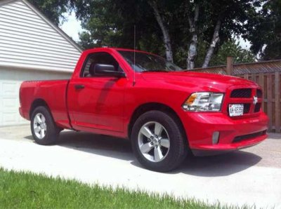

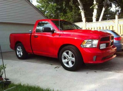

So I put the 2/4 spindle kit in and I have two thoughts
Damn this mother sits high!
Does it ride worse now?
Love to hear from other spindle owners on how they feel about the ride quality...
As for the "too high". Part I'm going to try a set of "stock height" springs in the front (not the "raised height" ones it came with) and see how it sits, then trim the rears to match.
Also curious if anyone has chopped out some of the tire height by going to a 31" or 32" overall diameter instead of the factory 33" tall ones. I can find pictures of lowered trucks but not with tire size details.
Thanks in advance!
Andy
For those interested you can follow my build on Instagram @ehmcj

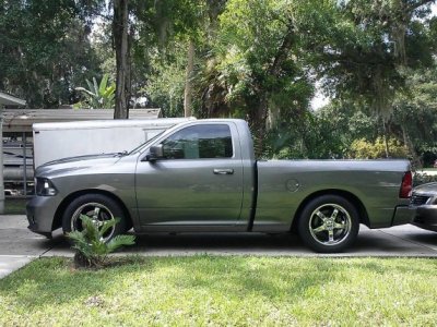

FWIW Spindles only lower about 1-1/2". I trimmed my 2" drop coils to get down 4".

Cell pic like usual, but it'll do.
Mind you, I have 30psi still in the helper bags from towing the trailer.
