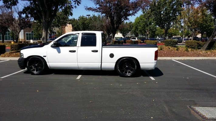

I run the same kit and my truck feels totally normal, I drive passengers around alot and no one thinks that the ride is harsh or bouncy at all...am running the belltech street performer shocks as well which I like better than the original belltechs that the kit came with...

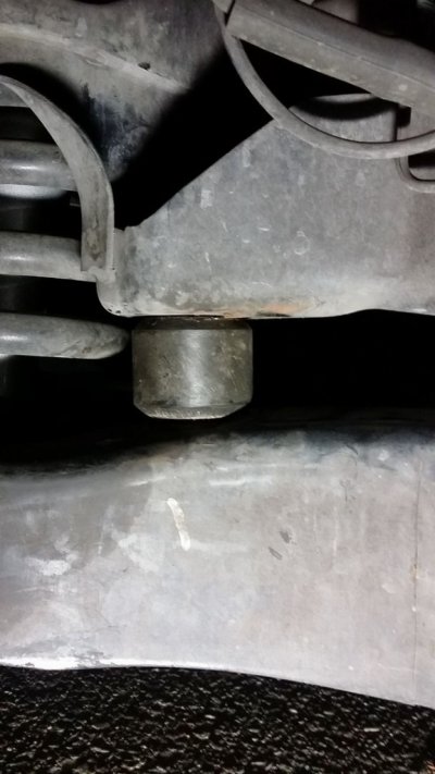

I'm 4/6 and use Timbren springs (rated rubber bushings) Keeps the front tires from rubbing the inner liners and the rear increased the load capacity by 1220# in the rear.
Rides like a stocker but a little firmer.

I might have to look at those again more seriously Greg...the new setup really fills the fenderwells

The Timbren springs are much more than bump stops they are an important part of my suspension. Fred I ordered set for a friend overseas and ended up with an extra set of front bumpers. These are the same as I'm using. If you are interested shoot me a PM.

+1 on using Timbren Aeon springs. I had them on my truck for extra load capacity prior to the drop and flip kit and they work really well.
Greg, what is the part # for the rear single stage springs you are using now? I think I want to replace the McG's bump stops in the rear with the Timbrens and maybe even do the front. I've done the 2" spindle drop in the front so the control arms are still at the stock height with the stock bump stops. I've managed to get the front passenger tire to stuff and rub the fender liner on one good bump at speed so far and I'm thinking the Timbren might help prevent this from happening again.

The part numbers I have are:
rear- A155-65
Frt- A140-65
