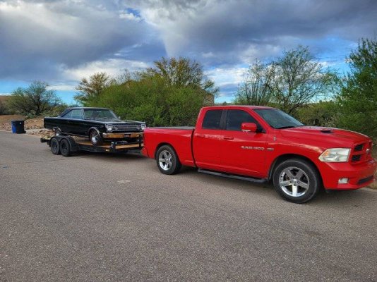

Value of MY truck is irrelevant. I like my truck and Im going to fix it.
Just have to make the decision to delete the MDS or put it back stock.
Honestly. My biggest fear if I go the delete it path.
Is the tuner.
Ive read some of these things can actually brick the ECM.
Plus any associated costs to have an outside shop " Tune it " so to speak.
Plus the whole Use it once to turn off the MDS and bump base idle , then put it in the toolbox never to be used again for a tuner seems foolish
I have it totaled up and this ordeal is going to be in the $2000-2200 range regardless of which way I go. So Im trying to do this right , and only once
