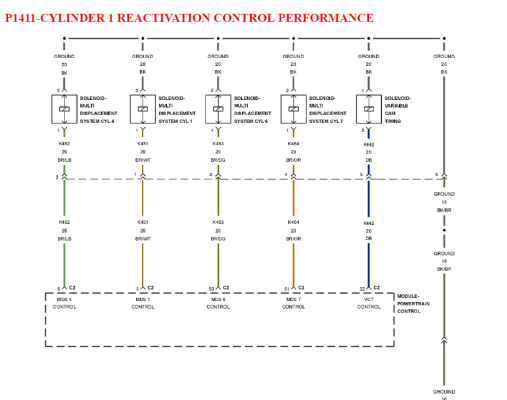

As to the concern about them shorting out, here is the wiring diagram for my 2013. Your 2010 is very likely the same:
As you can see, the solenoids have a continuous ground and are controlled by the PCM powering the + side of the circuit. This means that when MDS is disabled via a tuner, there will never be any power to the solenoid circuits. There will be nothing to short out.
But specifically, to answer your question, I'm not aware of any way to do away with the plugs other than just cutting them off. The MDS and VVT circuits are in the same jumper harness, so you can't just delete the jumper harness. It's possible that a VVT only jumper harness from a manual transmission equipped challenger, charger or 2500 might work, but that is just a wild ass guess.
