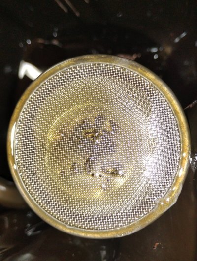

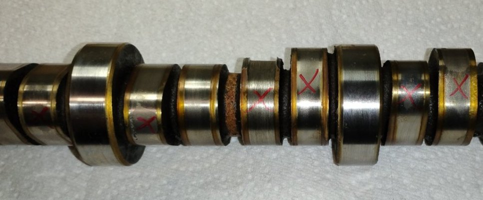

Misfire cylinder 5. Pulled it apart, that lifter is toast. Not much metal in oil, but some.
Vvt solenoid screen damaged, but no visible metal.

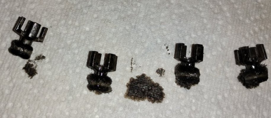

Pulled mds solenoids, cleaned. On the magnets below those solenoids there is some fine metal pieces.
On oil pump pickup tube a small amount of metal also.
Cut filter open, no visible metal.
Plenty of sludge in oil pan, but not much visible metal.
Oil pressure was decent 20+ at idle before teardown.
My plan is to replace cam, lifters, valve job, hv oil pump, and new timing set. I actually prefer mds when it works. Working on a budget here. Pictures attached.
Open to advice. Can I get by without a rebuild? Or time to do it all. Not looking for max HP or mods, just reliability. TIA

I see you have 195,000 miles on this engine. After looking at the camshaft photo and judging from your observations, what was your oil change and oil type strategy? What this often a short trip vehicle? I ask this question because you stated there's "plenty" of oil sludge in the pan which in my experience is unusual.

Thanks for looking at it. The truck has had oil changes every 3-5k for life. Idk how much sludge is normal, but there was maybe 1/4" in the bottom of the oil pan. The heads and other parts weren't gummed up though. Pretty clean actually.
Most driving is 10+ mile trips, 25-30 miles daily.

My ram always had 30psi hot idle. Still lifter failure ate a cam.
I'd be very concerned about your main bearings already ruined from the metal. Don't dump money into something not guaranteed. And this seems like a huge gamble.

Little tidbit for you,the high volumn pumps still don't put any more oil onto the cam lobes or lifter roller.There is "no" pressurized oil fed to them,they are strictly lubricated by the oil flung off the crankshaft,and you'd be farther ahead by using the stock oil pump and upping the idle rpm to 750.
You can look up from the bottom of the engine if the oil pans off and see the cam lobes,they're hung out in the open,with nothing feeding them pressurized oil
