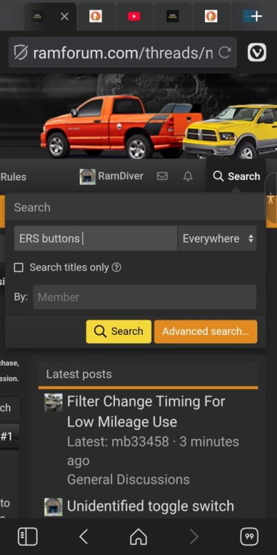

The search utility in the upper-right corner can be your friend too. You will find endless threads on this topic as well as discussions on how to really delete the MDS, why you should or shouldn't delete it, etc.
