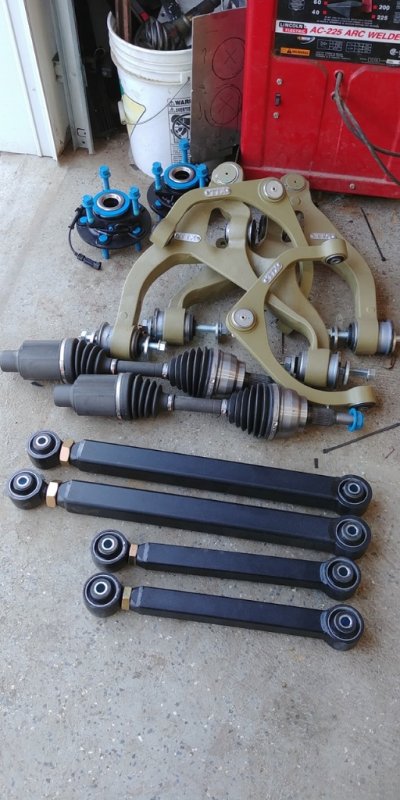

TTX, Suspension Maxx and 6112s
8JSHRJ&tn=r7skMo5aABLUiKrj&_nc_ht=scontent.fyxd1-1.jpgnc_ohc=Cawu4EApx8gAX-ypzqO&_nc_ht=scontent.fyxd1-1.jpg

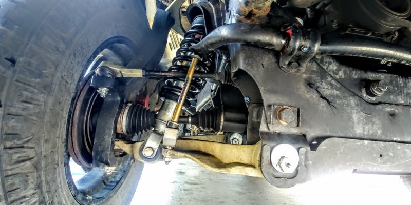

I put the Mevotech TTX UCAs on after installing 2 1/2" MotoFab spacers and having the balljoint start pushing out. No problems since and they were able to get it aligned. I also painted the UCAs with VHT epoxy suspension paint.
