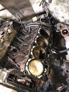

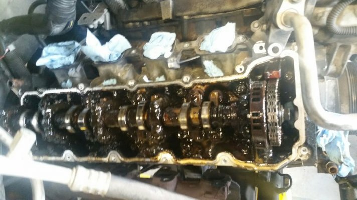

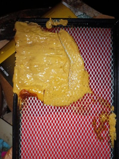

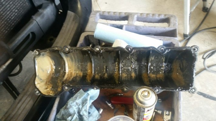

Here's how sludged up they can get:
Drivers side valve cover.
Passenger side head. Look at the sludge.
Some of the oil. 3 distinct layers, maybe 4

@Daniel Ortiz, I had the same milky stuff under my oil fill cap.
2002 1500 4.7L
Had been loosing coolant very slowly for quite some time, but ever since owning the truck.
Would get a puff of white smoke at startup, and a small amount maybe for a minute or so. Turned into more and more smoke and greater coolant loss. No puddles or hose leaks.
We had the truck almost 2 years with this slow coolant loss before it got worse.
After I let it sit for a day and cracked the drain plug loose enough to drip, green coolant after 4 or 5 drops.
To be honest, I believe the previous owner put stop leak in it, because when I had it apart, the heater core was plugged, had to use a garden hose on it to clear it.
The last pic is just some of the oil when I drained it to do the head gaskets. I put it in a couple of jugs. and noticed it after it sat and separated.

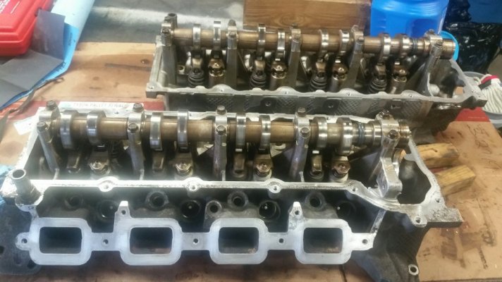

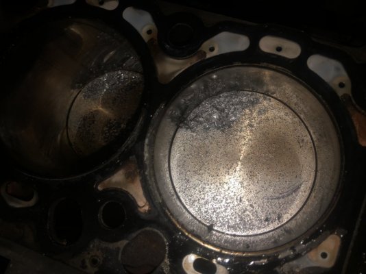

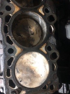

Can you tell which cylinder was burning coolant? Drivers side head:
Both heads, after a mineral spirits bath:
All timed and oiled, rotated a couple revs:
I remember back in the 70's when people were pushing water injection to help keep the combustion cylinders free from carbon build-up. I guess that's direct proof that it can work LOL.
Those affected cylinders do look very clean!
