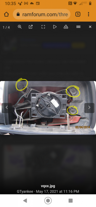

You need to remove the three torx screws that hold the front cover on the mirror. That cover locks the puddle light in by over lapping on the lip of it. Then you pop that tab and the puddle light will come right out.

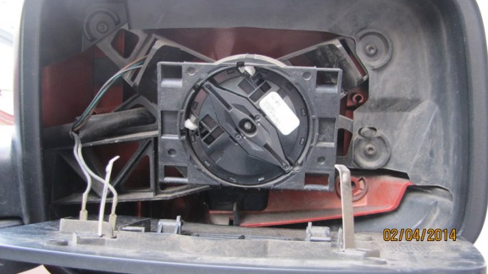

On the 2009 & 2016 trucks that i had & have ..............
I rotated the mirror down, leaving a opening at the top that i could look into.
I put on gloves because of the possibility of breaking glass
I placed my thumbs on the face of the mirror glass & 4 finger tips on the back side
Then i gave a jerk on the top side of the mirror, then i gave a slightly harder jerk & the top 2 clips released.
I looked behind the mirror again & wiggled it UP & towards my neck for a bit & it released the 2 lower clips.
I then detached the wires
If you should ever break the mirror glass, don't forget to switch the metal fingers from the old mirror, onto the new mirror glass
I read that they changed the mirrors a bit in 2018.
I would rotate the mirror down so that you can look behind the mirror & figure things out.
Maybe tell us how you had to do it :)

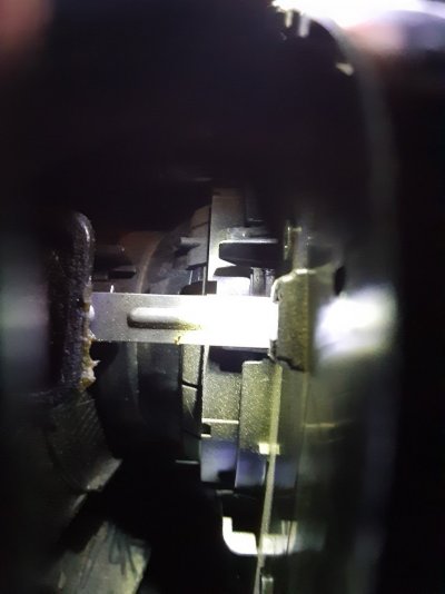

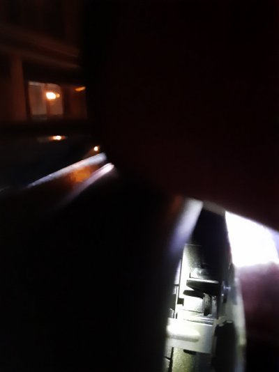

Thanks for responding. Unfortunately, I think I have different mirrors. I have a 2019 ram 1500 classic, and I just took a look. I am not seeing these types of clips. It almost seems from the look of that you cannot remove the mirror glass the way it is clipped in. It is hard to tell. I will keep investigating. I took some pics, but it hard to get a proper photo.

Ok, I found a video on YouTube. Here is the link: Different Side Mirror Connection This connection looks to be the kind that I have. The pertinent section starts at 3:40. I just have to figure out how the heck to pull the clip up and off with the mirror tilted down. Looks like this will be a fun one.
ASoundLogic
Mar 13, 2022
20
USA
Update on 2019 ram 1500 classic - I replaced the puddle lights on the driver's and passenger's side mirrors. I also noticed that my driver's side mirror actuator was not working in the left/right direction and lost the metallic prong that supports the driver's side mirror in the process. As it turns out, the driver's side mirror needed the screwdriver technique and the passenger's side mirror needed the suction cup technique! They used two different kinds of connection schemes on each respective mirror! I couldn't believe it, but that is how they were. I bought a big suction cup from Lowes and the passenger's side one came off after some manipulating rather easily. You have to kind of pull out and up. Then, it just swung down along the two bottom tabs and was easily removed. It is just like the one showed earlier by GTyankee. For the the driver's side, it had a different connection. The screwdriver technique is 1000% the way to go. You may see people online talking about just prying the puddle light tab while the housing is still assembled to the mirror, and in my opinion, the best way to do it is to take the mirror glass off first, remove 3 torx screws, take off the plastic mirror housing, and then install the puddle light.
