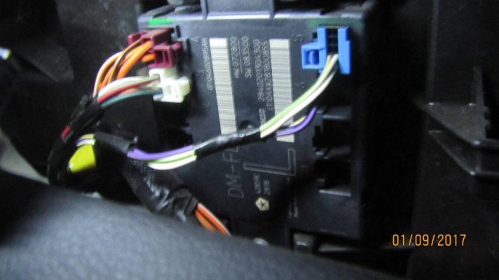

You may need to change the door module, they make 2 variations

out of my 2009 Ram, it was the only close up image that i have
