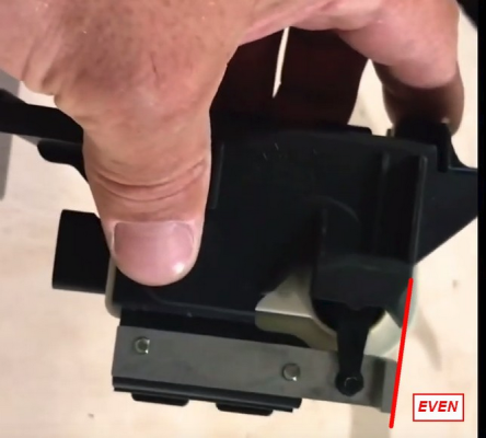

I would keep looking for the harness as it has to be there somewhere if you had shutters on it before. After you find it, modify the switch with the stop as seen on many posts and leave the shutters out. Mine have been upstairs in my garage since 2 weeks after getting the truck and all works fine.
