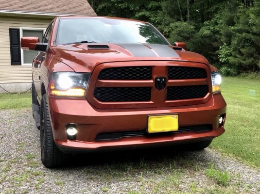

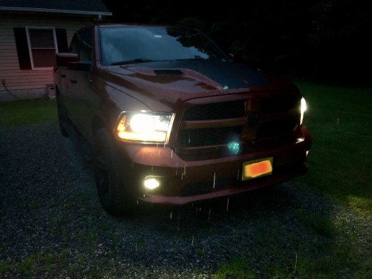

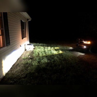

I removed my Morimoto XB LED fogs after a year... In short, they suck! Pictures look great but the output of 1200 lumen from the drivers seat at night is a complete joke... I have better output from retrofitted Phillips 65w 9012 halogens in the factory fog housing, and Phillips 65w 9011 halogens to match in my factory projectors. Plus no more dealing with igniters and ballasts going bad either! It's been a win win all the way around!
Here is the how to in case you want to give it a go:
https://sep.yimg.com/ca/I/yhst-91565365470012_2267_311973

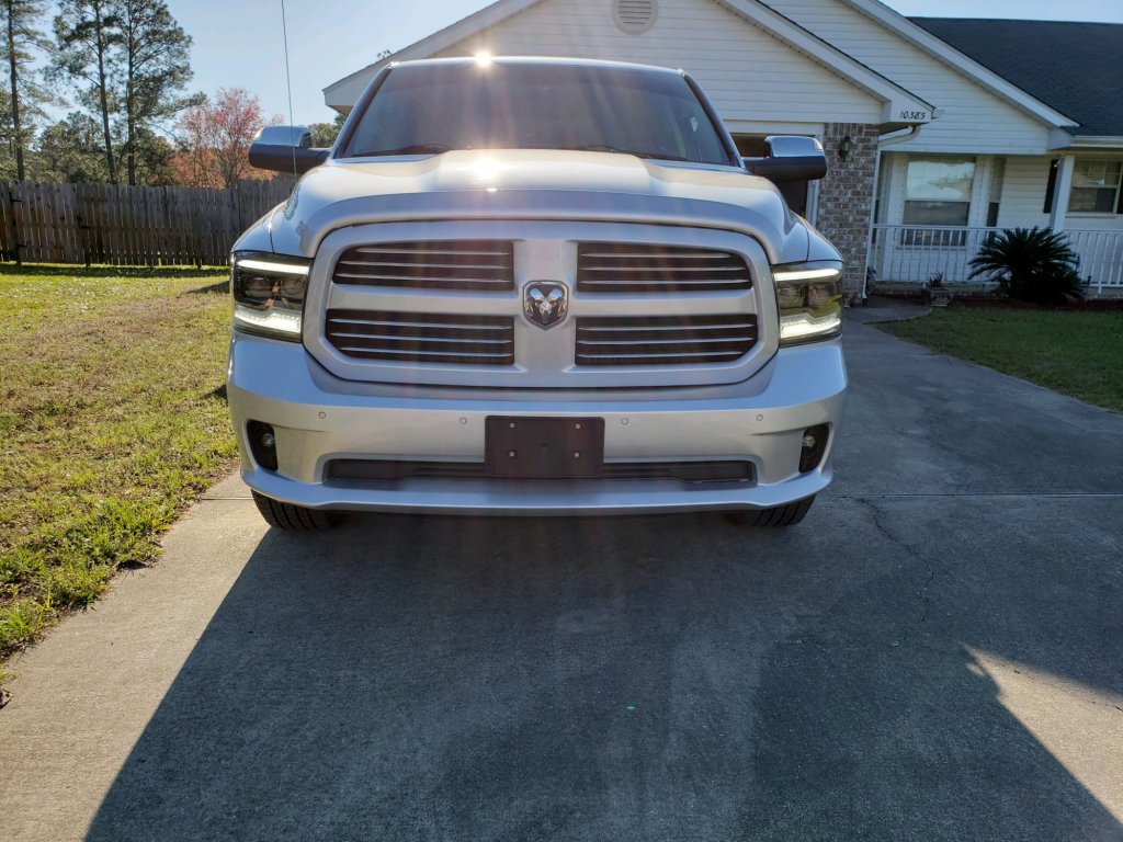

Have to agree. I bought his morimoto fogs and while they look good and match my truck they don't really do much in the way of output. I am thinking I will have JJ at the retroshop do up a set of painted to match fogs for me with HID's to get some actual performance.
