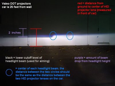

You use a #2 Philips screwdriver in the same spot as the factory adjusters.
There isn't any numbers on the adjusters.
With projector headlights, you set the lower part of the cut off line 2" lower @25' than the center of projector on the vehicle.
Do the driver's side first and then match the passenger side
Dont think I have factory adjusters as I replaced the whole bezel.
I cant adjust from top cause adjuster screw is the other direction .
Not sure how you can adjust with lights in mounted position.
It says not to go beyond 3 full rotations of the screwdriver
Also I'm to assume counter clockwise is going down.

If you have the XB morimoto headlights, see here https://www.theretrofitsource.com/media/custom/upload/Ram_XB_LED_Headlights.pdf
Pages 11 thru 13 deal with where the adjustments are, and how to aim the lights. The three rotation is for the adjuster. It take many turns of the screwdriver to equal one full turn of the adjuster.
