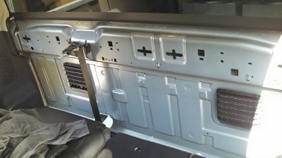

I have been researching the same ideas for My build and install. I have found some great ideas as well. Here is a pick I found on MDF with metal bracket that utilizes the child safety attachments behind the seat. No drillin very stout. Also has a bracket on bottom the attaches to seat bolt brackets.

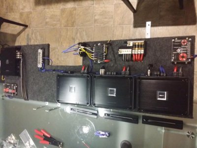

Here is a pic in the truck.

Wow.. amazing job... im just doing a sub amp right now.. but im sure i will be doing more later...nice setup.

Yeah I thought it was really nice work. This is not my build but I like the idea of running mdF across the whole back and fastening into the child safety and seat bolt mounting points. I then would be able to add foam and deadner to the back help to reduce roadnoise.

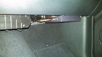

That does look really clean. I put my amps under the seats and the dsp is under the dash on the passenger side (see pic).
Second pic is the back panel, it might help with ideas... Oh, don't forget sound deadening. :favorites13:

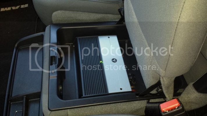

My JL Audio XD700/5v2 in the center console compartment under the center seat.

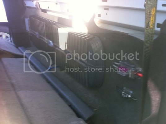

crappy pics but here is a few, i did have the other cap for the end of the amp just wasnt in the pics
A Rockford Fosgate Stack! reminds me of my 02 Silverado build... I wasn't too concerned about making too pretty since it was hidden behind the seats..lol
I still have the truck and the stereo gear works perfectly after 12-years. Just had to replace the JL Audio sub cause the foam surround disintegrated but learned later I could have had the foam replaced.
