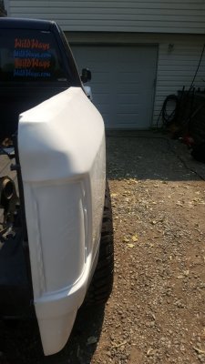

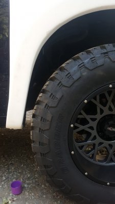

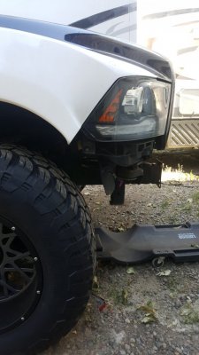

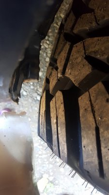

post some pics of your truck and some of fender clearance

Bear in mind ill be building a front bumper and they are fiberwerx fenders

More pics I wanna see my fenders better .where did u get them
Ill take more pictures later today, Fiberwerx is the brand of fender.

Here are pictures of the whole truck. Just started on the project and most likely wont be finished till spring next year. Personally i like the height it sits at now. I have contacted a company that makes long travel kits to see if they will do a one off to move the wheels forward. Just waiting on a reply.

So i contacted a company and they suggested trimming the fiberglass and cutting the firewall to achieve the fit other wise lift it. What does everyone think about trimming the firewall. It mainly is just the seam next to the rocker that needs trimming.
Trimming the seam is no big deal. I just trimmed mine at fit 37"s. Start at the bottom, moving back 1", start cut there and taper it up 5"-6". Touch up the paint and you're done.
