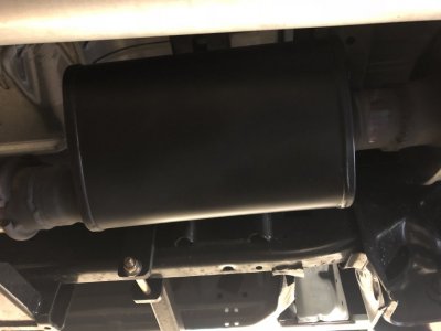

Check this out. I told my exhaust guy I really don’t want it too loud. So we took the factory muffler out, put in a pretty standard magna flow muffler and repositioned the resonator in line behind it, then came out the back with a 4 inch pipe. The sound is perfect just what I wanted. The good thing about this if it’s not loud enough for you, just take the resonator out.

Well put MagnaFlow muffler on and removed resonator. Sounds awesome at idle but 1800-2000 rpms the done is brutal.
I kept resonator and am going to drive it for a week or so and if the drone continues may put factory
resonator back on.
