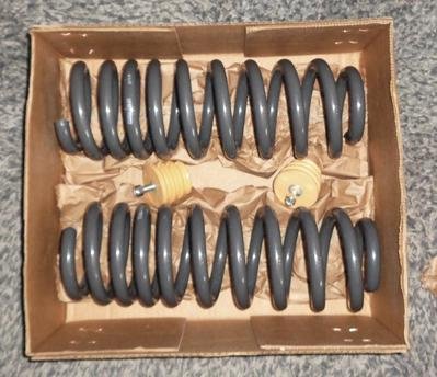

Belltech 4769 front 2" drop coils (he swapped out the OE length coils in the new struts)
KYB strut bushings w/bolt
(don't know why there were bump stops w/front coils, my truck has none up front)

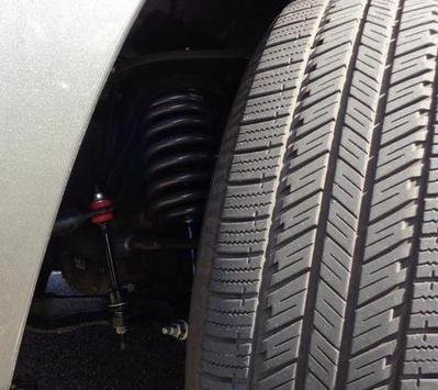

Here's everything installed

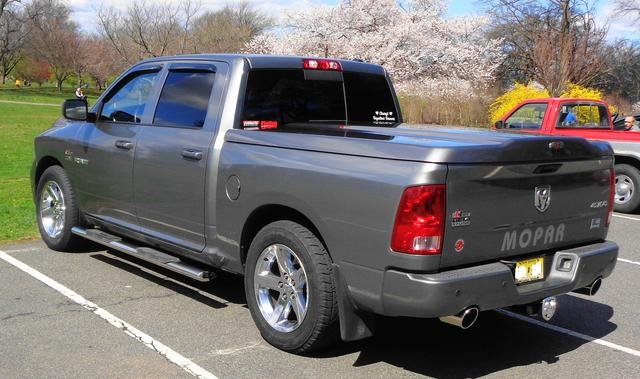

Here's before and after shots
I'm totally happy with the ride and stance now, don't want it any lower and love the even rake.
Total for parts was $650, labor was $850. So for $1500 I got a 2/2 drop with all new front end components.
