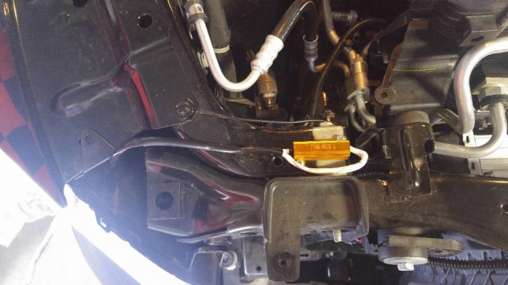

WELP... I sent EVERYTHING back except the basic $60 HID kit and bought this harness:
http://www.amazon.com/gp/product/B00FOX56H0?psc=1&redirect=true&ref_=oh_aui_detailpage_o02_s00
It works AS EXPECTED with just that single harness. The passenger side has a resistor that connects to the factory harness standalone. The driver side resistor is wired into the relay harness. Here's where I installed them on both sides.
SOOOOO in conclusion... the HID system still ended up costing under $100 and if anyone has any questions, I'd be more than happy to help. I know what not to do, what to do, what parts will work and what parts won't....
