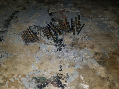

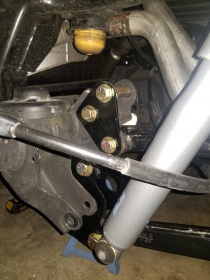

Boy you aint lying it seriously killed me. All i got left to do is to torque bolts and to put shocks and springs back in. I just wanna give a shoutout to garys hemi a member on here. He helped me get through the painful process. I am anxious to see what these brackets are about. Seem solid as can be. But dam i went throught some drill bits half being harbor freight though. And the drilling angle can be difficult but it all come out in the wash.

Glad to help out man. The install sucks, there is no other way to put it. Would be alot better install w/ 1/2" hardware instead of 5/8". They are worth it in the end though.

Well when you think the hassle is over its not. It took everything i have to torque all the bolts to 180 ft lb but i got it done. Tommorow will finish springs and shocks and i shall be done.

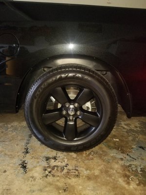

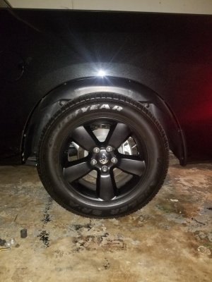

Well i got it all on finally. Have yet to drive it but so far a very well thought of kit and seems solid. A picture of a centered wheel hell ya. I cant wait to see how it performs. And again was a job to install.

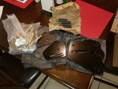

Illicet no cut brackets

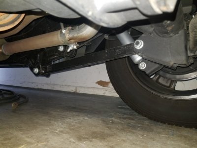

The Spohn adjustable panhard bar is good. People just dont like the Spohn upper & lower control arms due to the bushings/joints in them.
The front sway bar endlinks that you want are 2008 Ford F150 endlinks. Those bring the sway bar back level to work properly
