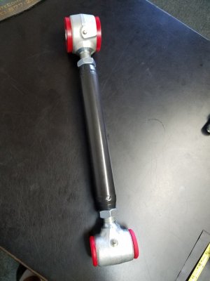

Thanks W1. Parts list above is just for the bushings 2 ea of RH & LH? What did you use for the arm itself?

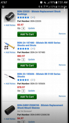

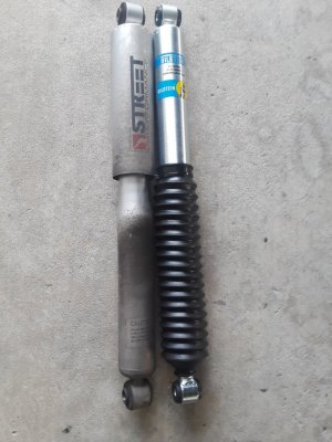

The Bilstein 5100 rear shocks in this pic are the same exact height extended & compressed as the Belltech Street Performers. I installed them after my 30,000 mile Belltechs were done for. Much better ride & handling. Just need to install the bushings in the summit order picture due to the shocks coming w/ too small of bushings/sleeves.
Also I have 2" Belltech springs up front w/ stock height factory replacement Bilstein 4600's up front. Have had them fro 30,000 miles. Great shocks for a lowered set up. They help take bump steer & body roll out if the lowered set up
View attachment 116118 View attachment 116124
Are those Ram 1500 specific rear shocks, or did you source that part # based off the dimensions?

They are not Ram specific. A fellow member on here Moregrip spec'd them out w/ a Bilstein rep for our trucks thats lowered 2/4. He is more into autocross and wanted a good performing shock that didnt break the bank. The shocks ride great. A little stiffer than the Belltechs, no body roll & handle great.
