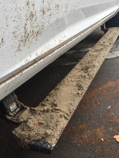

HemiPower36
May 16, 2014
1,424
839
CA
2014 Ram 1500 Laramie 4x4 3.92 8-speed
Any step other than the amp is gonna hold mud snow and ice..... Just the way it is.
Sorry brother, that mud gets everywhere. Of course, this happened to me while I was "playing" after it rained. Nothing a garden hose can't wash off. Plus, the truck is filthy anyways.
