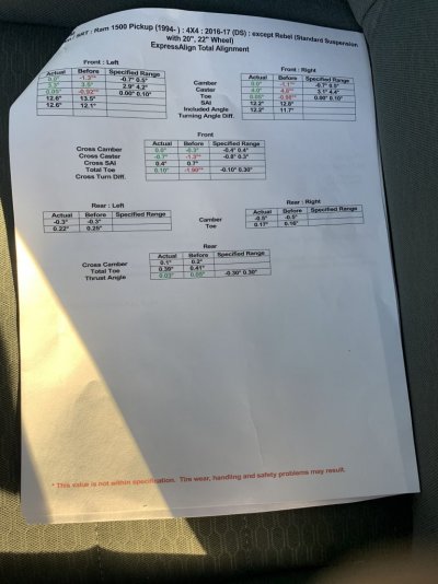

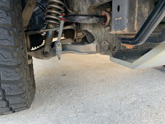

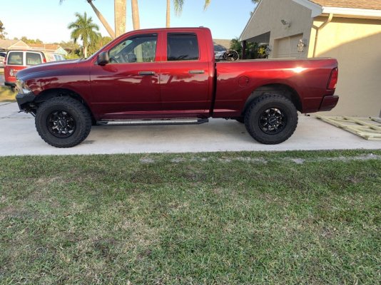

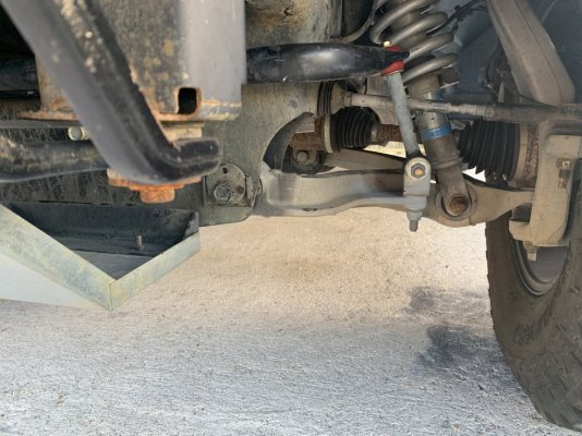

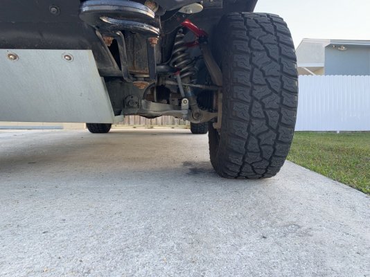

Got my alignment done today. The cam bolts look to be in a lot better position with these jba UCAs over the zone UCAs. And a picture of my cv axle angle for reference. Bilstein 5100 and eibach springs set to the second clip with a 1/2” top hot spacer. 3” total front lift over stock. 1” rear lift.

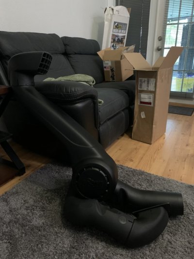

Look what showed up. Been wanting one of these for around 2 years now I think.

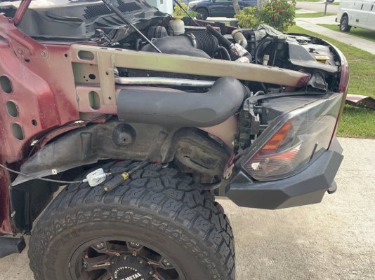

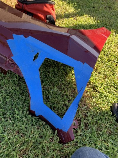

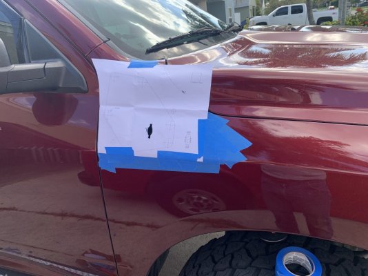

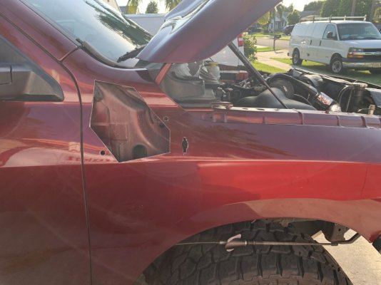

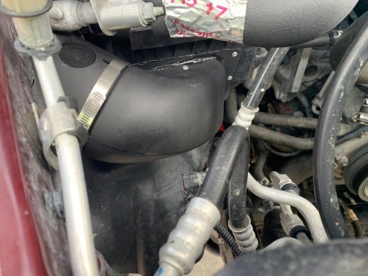

Started install. All that’s left is the cutting portion. Used clear caulking on the air box portion. Will use clear caulking on all other connections at time of final install. It is not silicone. It is a “all weather hybrid clear caulking” for bonding of materials that includes pvc and plastic. It’s definitely a tight fit. And removing and reinstalling that quarter panel is definitely awkward by yourself

Looking good. Don't know if I would be that brave. Granted I had to cut the frame to do the lift. But I have a welder if I f'd up and no one would know but me.
I’ll be doing the cutting either tomorrow or Friday. I’m really nervous about it but gotta live with it. I have spray primer to put on everything after cutting to prevent the rust.
I wish you the best of luck man. No f'ups. Make me want to buy one. :)
Just remember- if you really F it up- you’ll have a good-er excuse to get some fiberwerx fenders ;)

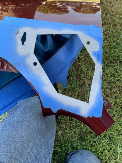

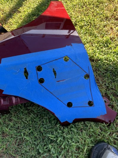

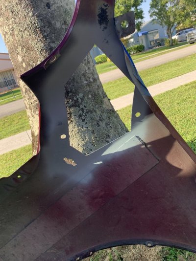

Test fit. Will spray more primer/rust inhibitor before final fitment. Snorkel to be installed tomorrow so the primer has enough time to properly cure.

NICE. Looks like things are moving right along. Was it nerve racking???
