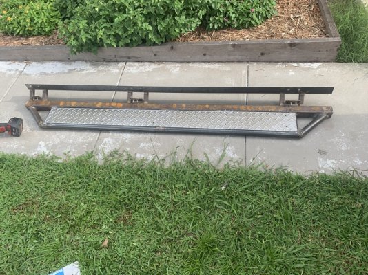

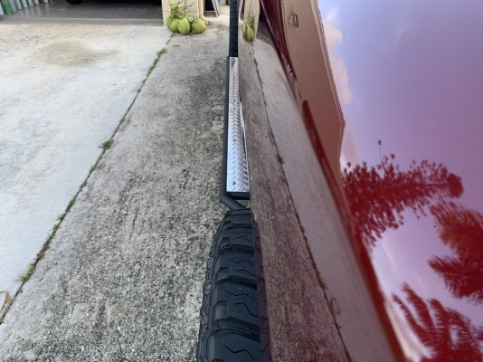

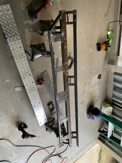

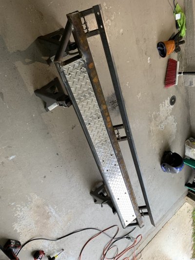

Ended up settling on aluminum tread plate. My local shop had aluminum tread plate in stock. I wanted steel so I could weld it in but this will do just fine. Putting 2”x1/8” steel plate across to bolt the aluminum tread plate to. Will have the steps powder coated black and I’ll leave the aluminum bare. They’ll match my wheels.

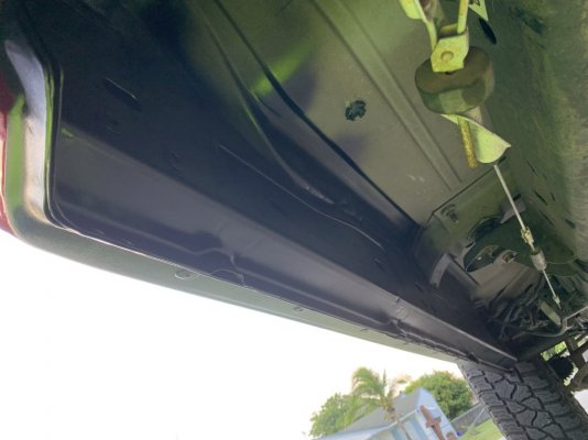

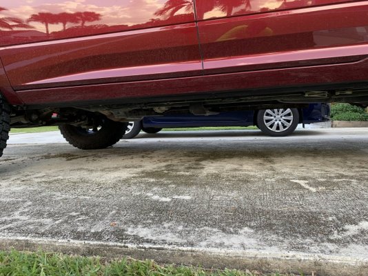

Decided to spray the whole lower rocker panel section and inside of the rocker panels with spray bed liner. There’s a ton of rock chips. Cleaned it up with a scotch bright pad before painting. Have an appointment to get my steps powder coated. Feeling pretty happy with how this is turning out.

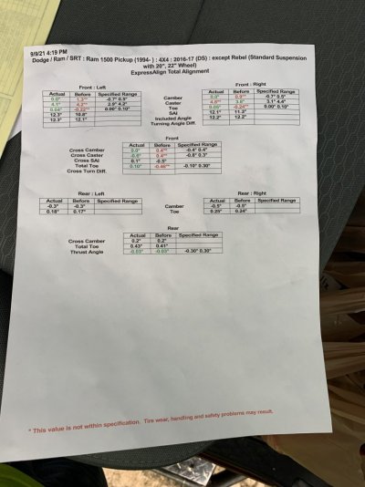

Had an alignment done. Well had 2 different alignments done. Went to Firestone, I have a lifetime alignment setup with Firestone, originally, and they couldn’t align my truck. “The machine must need to be recalibrated. Sorry”. So I had to schedule another appointment with 4 wheel parts. Needless to say I don’t think I’ll be using Firestone ever again for my truck. Made sure to file a complaint with their corporate hotline. They sent me home with an alignment worse than I showed up with after my truck was on the alignment rack for a total of around 2.5-3hrs. Truck pulled excessively to the right. That was on Saturday. Someone was supposed to call me Monday or Tuesday and nobody did. I called and spoke to the store manager and he told me he didn’t know what I was talking about and I could always bring it back or take it to one of their other stores. Thursday was my appointment with 4WP so my truck was not driveable until yesterday afternoon. First picture is my alignment sheet from 4 wheel parts. I don’t have an alignment sheet from Firestone because “the printer is broken”. However, the sheet from 4 wheel parts shows how bad my alignment was from Firestone in the before. The last 2 pictures are my cam bolts after Firestone did my alignment. Driver then passenger. 4 wheel parts told me that they thought I had a bad brake before doing the alignment because of how aggressively the truck dragged right. Now after alignment I have zero issues. Waiting on corporate to call me back after they look into the situation. Video here

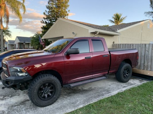

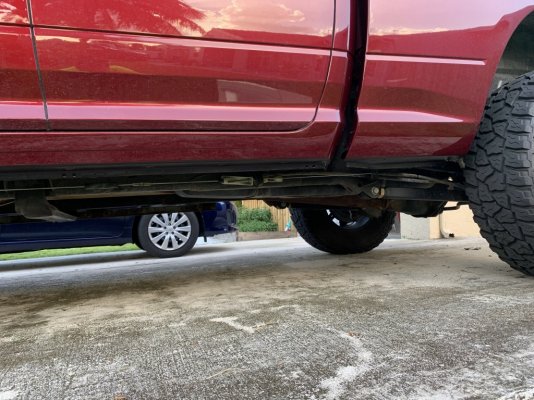

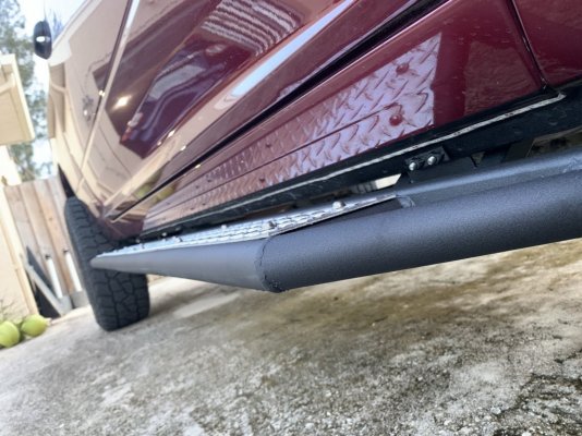

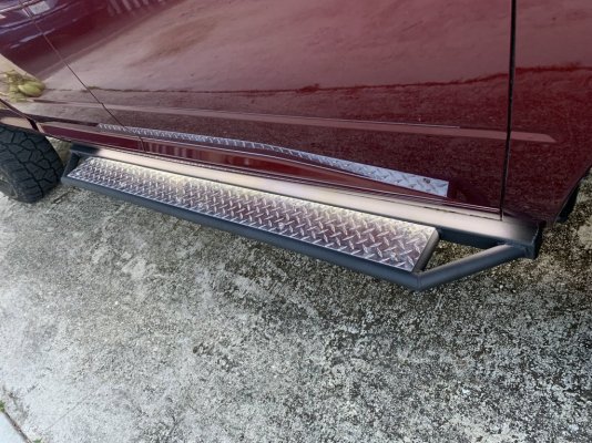

These things came out amazing. Super happy with the final outcome after having them powder coated. Removed my old rock lights and installed tape light under the rocker panel and wired them back to the footwell lights since I’m not using the footwell lights.

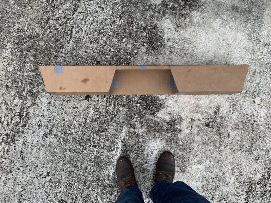

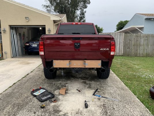

Bumper Mark 1. Will have to remake the bumper out of 6” x 4” rectangle instead of 6” x 6” square or the tailgate will hit the bumper. Time to design mark 2. The bumper will have 1.5” round tube protruding from either side of the bumper and will wrap the outside like the stock bumper does.

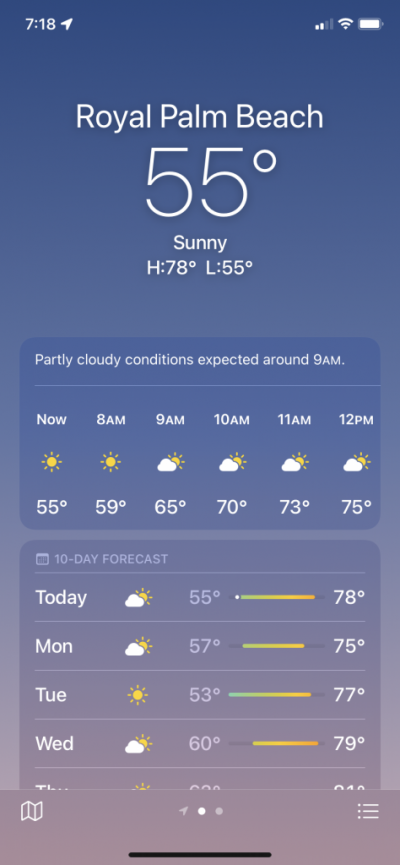

Oh man it’s so cold today here in south Florida. It’s a brisk 55° this morning. Lol. Not much new. Emailed synergy about their jeep gladiator springs. They have listed online that they have a 1” spring coming soon so I asked them what the extended length is and when the expected release date is. The plan is to lower the front down .5-1” and drop the rear back down 1” as well. May just end up with the 2” springs depending on what they say. New rear bumper and tire carrier will add a good amount of weight as well so that should help. Also ordered a new tonneau cover. Mine has sprung a leak around the rubber edge seals. Ordered a truxedo sentry to replace my bakflip fibermax.

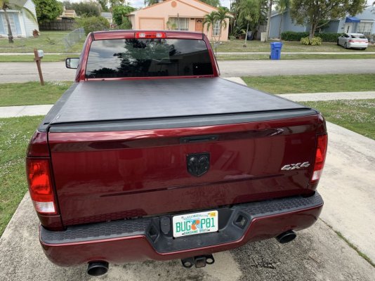

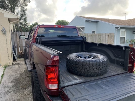

New tonneau cover from truxedo. It’s the truxedo sentry hard roll up cover. Fit and finish is great. It’s a bonded vinyl over aluminum slats. Hopefully it holds up for more than 3 years. My bakflip was 3 years old and starting to fall apart and leak. Will see how well the new one does for staying dry.

I haven’t really had a lot of water in the holes when I had the bakflip. I was looking at getting stake pocket fillers with hooks in them for strapping. I’ll just never buy a fiberglass folding cover again. I think that’s part of my issue I had. The fiberglass was flaking and getting nasty. Probably because my truck sits in the sun all day every day. And yes. I really needed a hard cover and wanted a roll up and this fit that perfectly. Honestly it’s even lighter than my fiberglass cover. And hoping the vinyl will hold up better than fiberglass. I already ordered the spray for the vinyl cover too.

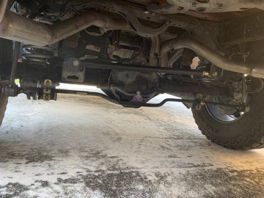

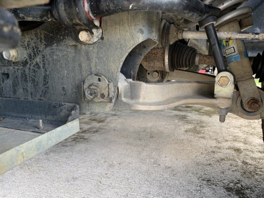

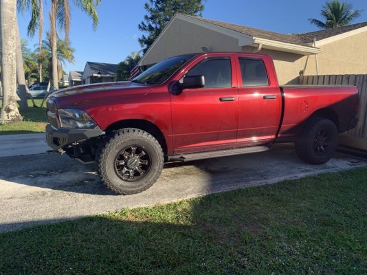

So I’m loving the new tonneau cover. Fit and finish is great and I can use my back window with it full open which is awesome. Also decided to measure my fender heights again and driver front was 1/2” lower than the passenger and it was bugging me because it was really pulling on the front sway bar. So I did what any “sane” person would do and disassembled the entire front end and adjusted my front struts. So now my truck sits at 39.5 front ground to fender on both sides and 41.5 rear ground to fender both sides. Half tank of gas. Lowered both sides of the front. Driver side is at the second clip and passenger side is at the first clip or zero clip. Truck looks pretty nice at this height honestly. 2.5” front and 1” rear over stock with 35s. And now my front sway bar looks happier.

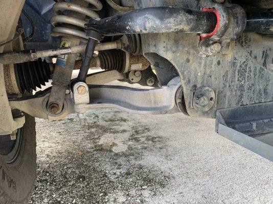

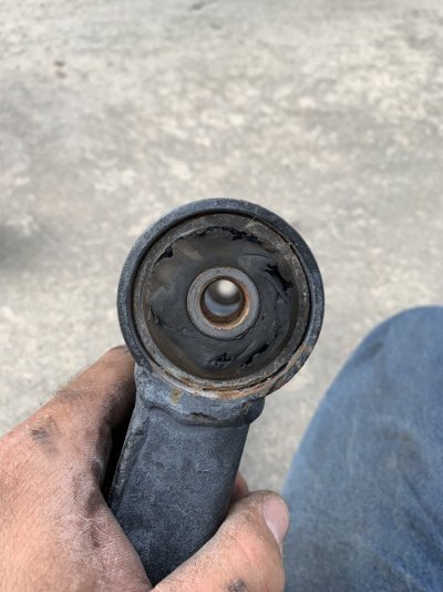

Ouch. Time for new UCAs. 30,000 miles and had a bushing fail. Back with new zones or go to icons? What’s the reliability on the poly bushings long term?

They should last more than rubber inherently because of the material but mostly because in the the case of the A-arms, the arms pivot from the mounts in those bushings up and down. the rubber bushings are fused to the sleeve and the housing so they're not designed to freely rotate per se so the bushings have to literally be forced to deflect up and down as the suspension moves which is why is supper important to preload them at ride height. they're not designed to take into consideration more shock travel so assuming a standard length strut and stock heigth the'll work well within their operating range. Top spacers forces them to flex more than normal.
Poly on the other side will rotate freely around their sleeves and depending on bushing design they can also rotate in the housing or around another layer outside the sleeve like many flex joints, Giiro DDB's in Claytons, and other flexy DDB's. We don't have that type in the front UCA's nor is needed. a normal free pivoting poly busing will work well cause all the a-arms do is go up and down as the coilovers cycle, so you don't even need to worry about tightening a little above ride height cause they literally free spin.. and they don't deflect side to side like rubber can so your suspension from the pivoting arms have literally no side to side movement which you want if you're playing in the dirt at speed. Zone are not exactly performance UCA's in that sense because their rubber bushings for the pivot points and standard bj's. Don't mean to say they're bad UCA's though. On the contrary they're more HD than the stockers, but if you are playing in the dirt and have extended travel suspension, poly busings with a bj than can flex more like Icon DJ, JBA BJ, any of the good brand uniballs etc not only will outlast Zone but will give you all these benefits pretty much in full. Yes a bit more maintenance but it really depends on your needs. I grease my Icons every 5k miles, have yet to hear a single little sqwueak from them and i felt the difference right away when i made the change from Zone to Icon on the street but more when pushing the truck in those Socal washboards we have around :) If you wanted to try something a bit less pricey i think the JBA's are the ticket, but you still have to grease them. is not that bad though. At least with the JBA's you wouldn'tneed to loose and retorque your bolts from the UCA pivots like we have to do with Icon for example.
Yea. I’m going to fix these zones for now then swap. I’m looking at swapping to jba most likely for the easier greasing but the icons just seem so appealing. I’ll keep my zones I guess or try to sell them. I like your explanation.
