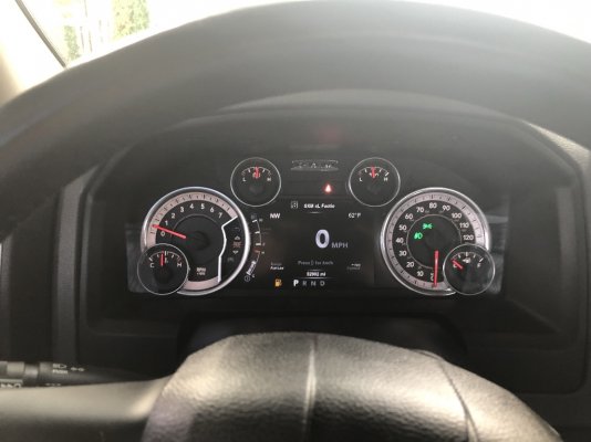

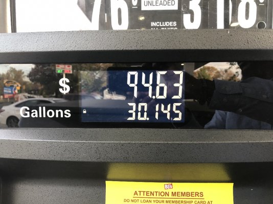

I am not sure if it was just one time. But for the first time I was able to put in 30 gallons. This was bout 5 miles (or 15 mins, NY traffic) after my miles remaining switched from a number to “Low Fuel” in the fuel range indicator:
It may be a fluke, or just the timing. But the last time I tried this, I think I got 27 gallons after driving 80 highway miles past 0.

This is exactly how it SHOULD BE. As soon as it says “range: fuel low”, you should be able to put 30 gallons in.
It was never like that before. But, the software update for the added auto park did not mention anything about fixing the fuel gauge issue. So, I’m wondering if this was a fluke, or the new normal...
