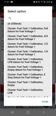

I did find those. My capacity was set to 0 so I had changed it to 121 liters.
The full and empty was 98% & 2% so I changed it to 5%. I guess I'll wait and see what happens. There are other settings too for 3/4, 1/2, 1/4, E Stop, & Empty datum for fuel voltage but have no idea what I'd change there so I left it alone.

I copied my post below from another thread so you can see it can be recalibrated for the 52 gallon tank and should be accurate.
Instead of 121 liters (32g), you would change it to 197 liters (52g).
see below.
Theres a few threads on this matter which I have posted on about using AlphaOBD app to recalibrate the CLUSTER readings of the gauge to coincide with actual fuel level.
Like others my fuel light would come on @ 50 mile range. When I would fill it would only take 26. At most it took 29 and that was with the gauge on E hard for 25+ miles. My 2018 CTDHO truck has the 32 gal tank.
So I went into the Body module using ALPHAOBD and changed some settings. One thing was the capacity to 121 liters (32 g) . I also changed the Cluster Calibration percentage readings for FULL, LFW, & EMPTY to the highest for full, and lowest for empty and the LFW I think I set to 2 or 5%.
I ran a test initially after the recal. I filled the tank and ran it down to 1/4 tank on the gauge. Upon filling, from 1/4 to half it took 8.2 gallons. I continued to fill to half and it took another 8 gallons. The to full it took another 8. Since it's a 32 gallon tank it looked pretty promising my gauge is accurate.
Final test I ran it empty yesterday. the 50 mile range light came on with the needle in the red. I continued to run it until the needle was down to E and range wouldn't give miles anymore. I filled the tank yesterday morning and sure enough the pump clicked off at 31.7 gallons with me able to top it off with 32.2 gallons. I don't normally top off but I wanted to see how much more I could squeeze in.
Conclusion problem solved for me. I'm going to run this tank low again and see if it has the same results.
