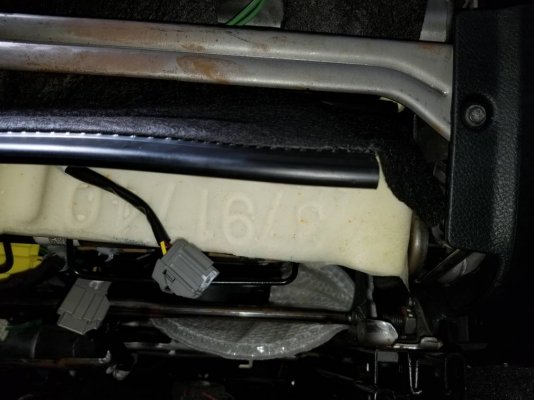

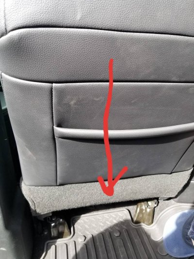

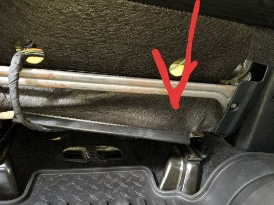

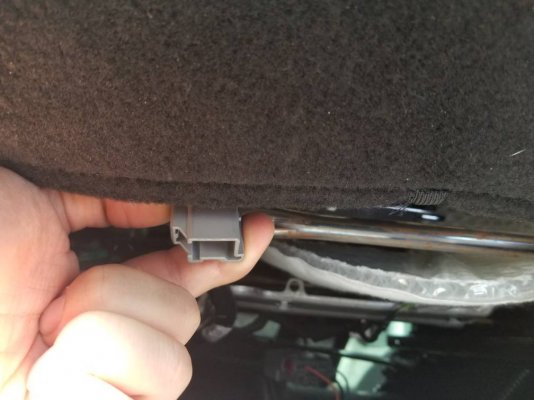

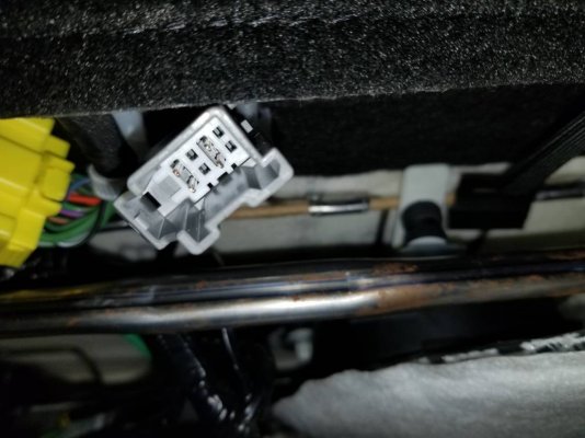

I have a mysterious open grey Male connector under my drivers side seat. Looking at the seat from the back seat, it is right in the middle behind the 'felt' panel that can fold up at the bottom of the seat. You can feel it without folding up the panel.
I recently had my seat cover replaced due to stretching and when I tried to use my heated seats yesterday, they didn't work. I would press the heated seat button, it will light up for three seconds and then turn off. I've tried using the heated seats after both remote starting the car and manually starting the car. This leaves me to think that something was not connected after the seat was replaced and this must be the heated seat connector.
Could someone with heated seats look under the back of the drivers side seat and see if there is an unused grey Male connector? Does anyone know which connector is for heated seats?
Should there be any open connectors under my seat?
Will post a pic after work today, thanks.

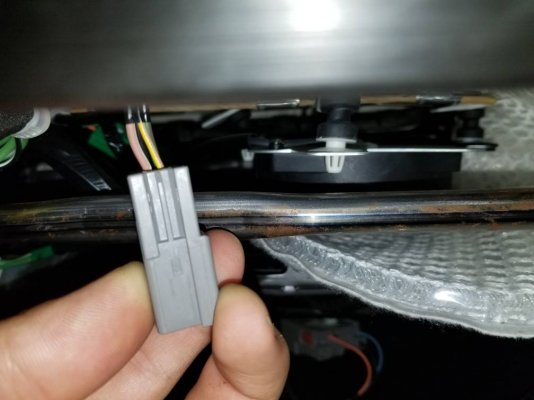

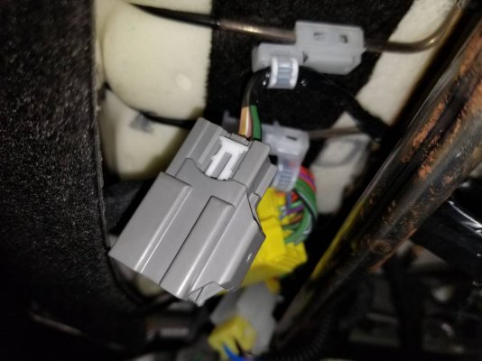

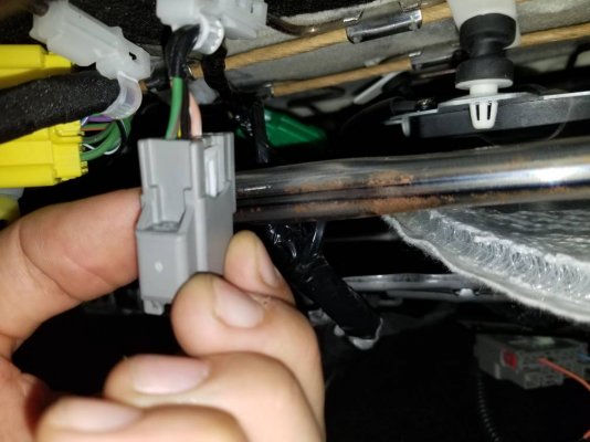

Here are the pictures 7b71271ea37d5bedf4eee07cefcd9c6b.jpg36bdff2b26c11b8835a40451c623c18c.jpgfd945d092f28f631c5b6a33bcedb246c.jpg4376b5ead6764080bf1397dab4ae84e7.jpg

Welp I found it. It hadn't been connected and was stuck under the seat cover still. All good now 78620e2f5706e9cdf0ed5c6af4861dde.jpg64276294970bf5af6c84d4248ee14bf4.jpg

That is for the heated seats..
