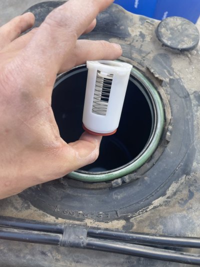

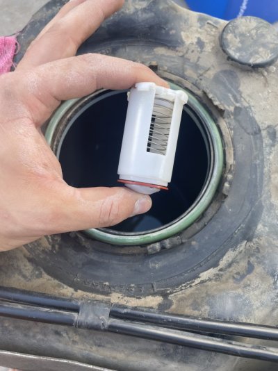

Hey guys I’ve been having some fuel pump issues on my 2012 ram 2500 5.7 hemi (ran a fuel pressure test and had about 10 psi and very quick bleed back) and dropped my tank and pulled my pump and when I pulled the pump I found this part at the bottom of the tank, compared to the new pump, doesn’t look like it comes from the pump. Maybe from the tank, if you guys have any ideas or guesses, it would be greatly appreciated thank you

Just a guess but I'm gonna say maybe from the roll over check valve???Try to peek around in there with a mirror and light and see if you can spot where it might have come from.
