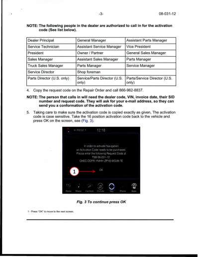

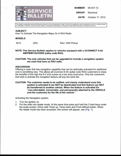

RAM TSB 08-031-12​
Make: RAM Number: 08-031-12 Date: 10/17/2012 Title: How To Activate The Navigation Maps On A Ra3 Radio Models:
  • 2013 1500 Big Horn
  • 2013 1500 Express
  • 2013 1500 HFE
  • 2013 1500 Laramie
  • 2013 1500 Laramie Limited
  • 2013 1500 Laramie Longhorn
  • 2013 1500 Lone Star
  • 2013 1500 Outdoorsman
  • 2013 1500 R/T
  • 2013 1500 SLT
  • 2013 1500 Sport
  • 2013 1500 ST
  • 2013 1500 Tradesman
Summary: Offering a radio that has navigation capability that can be optionally activated for additional cost is something new. This allows all Uconnect 8.4A (sales code RA3) customers to enjoy the benefits of the high line 8.4 inch screen at a low entry level price. Only the customers that wish to activate the navigation feature will pay the extra fee.
