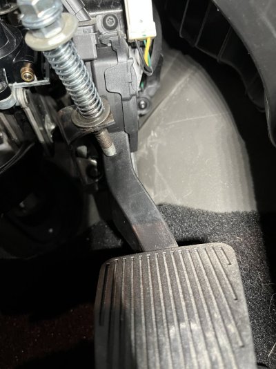

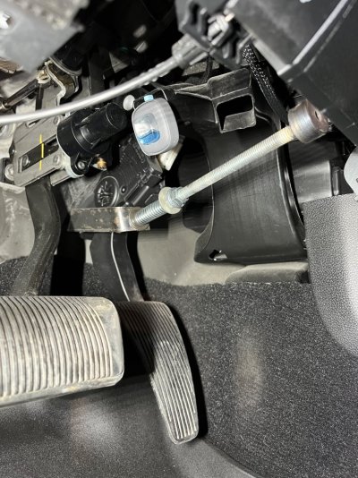

I was wanting the exact same thing, for similar reasons. Im pretty versed in auto electronics, but I just couldnt find a way to make it work well with the factory cruise buttons without having to create another module which could control it.
I went completely analog, but I didn't want any prop rod in the cab or visible mechanisms.
Works OK. Not great, and not bad. It could definitely be perfected. The thread pitch seems too course at times, and too fine in others. It works for what I want to do with it. I use it as more of an adjustable stop, than use it to adjust the pedal. Set desired engine speed with your foot, and set the stop against the pedal. Unthread it when done. Cant see it unless looking low under the dash, but can find it with your hand easily. It took some figuring to make work with the adjustable pedal system.
Its just a bent piece of flat stock, a hole drilled in it, with a flange nut tack welded on the firewall side. Some threaded rod and a spring to keep it from rattling, with a small knob welded to the end. The factory holes and bolts for the APPS hold it in place between APPS and bracket.
My hats off to you RDJ,that's a hell'va an idea :waytogo:
Thank you.
Normally Id like to do something a bit fancier. Its the only thing on my truck where I'd consider it "good enough", and that kind of bothers me.
I was thinking of making an adjustable PWM solenoid that can be easily adjusted. Again, this would be so much nicer to use the software already built into the truck, but software isn't my strongest area.

Id thought about something like that as well, but it would have to be a very very slow actuator (which I'm aware exists). The pedal is very sensitive that close to the fulcrum. It shows in the analog version I've made.
Maybe on the next design I'll incorporate something like that. Thanks!

With the actuator being so close to the fulcrum, small small adjustments make a big difference. If I used the threaded rod to move the pedal, it overshoots all the time. There is no "sticktion" in the APPS, its quite touchy. With your foot being a good bit of distance away, its far less touchy, and easier to press.
