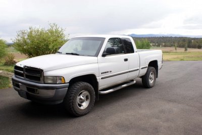

Hi folks,
This is my first post, so I guess I owe an introduction. I've been a Dodge fan since I've owned a Viper in the early 2000's and last year bought a used 99 SLT Laramie for my ranch in Central Oregon. I like it, and my dogs seem to love it even more !
It seems to be that the exhaust is starting to act up (still OEM) and I am now looking for a replacement. Objective would be to do this myself (I live pretty remote) when I visit the property (I only spend about 30 days a year over here - I know, long story). There is no need for performance (I own a 600HP sports car on the East Coast), but I would not object against a more efficient flow and/or better fuel economy.
There is no issue with salt being used here in Winter, so in conjunction with hardly seeing any usage (maybe a 1,000 miles a year), what would you guys recommend ? Would be great if I can just order from Amazon or eBay and have it dropped off at the ranch. Thanks !
