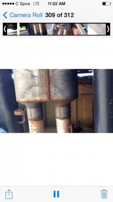

It won't let me upload multiple pictures so I gotta post them individually. Bare with me
Lkw88
Lkw88
Apr 5, 2014
187
25
2005
Muffler
