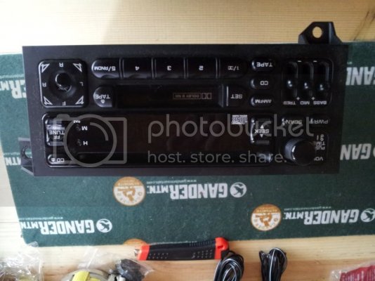

I have a OEM infinity HU with the CD and tape . PM me if you want it . Came out of my 01

Thanks Dave. PM on its way.
