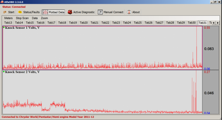

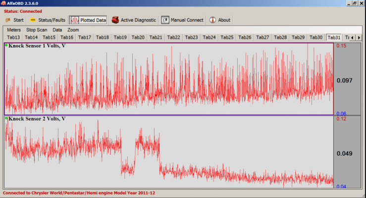

2 month ago I faced a check engine light and pulled the code P0330, generated when a (intermittent) malfunction is detected in the knock sensor 2 circuit that causes it to not operate properly.
So I replaced both knock sensors on the Pentastar. 4 weeks later, the same code back.
I just hooked up a scanner and polled the sensor voltage for both.
When the engine is cold, both have pretty comparable voltages and voltage ranges, see the first section in the first screenshot.
After about 2 minutes, the 2nd sensor dropped in voltage range for maybe 20 seconds or so.
After being in the normal range for a while, it dropped again and stayed in the lower range ever since. The voltage is basically cut in half on sensor 2.
I wiggled the plug in the sensor, it was fully seated.
Wiggling the plug, the cable, the attached harness and the first large connector right next to the engine, while it was running, didn't change the voltage, range or function at all. So this doesn't look like a broken wire or a bad connection.
I took a wrench and hammer to the right side of the engine block, standing in-front of it, close to the 2nd sensor, and wacked it pretty good. Both sensors reacted, see the 2nd screenshot.
My conclusion so far is:
- The intermittent drop in voltage range on the 2nd sensor goes along with the error code, also claiming it to be intermittent.
- The drop seems to be related to the engine temperature.
- Since I replaced the sensors 2 months ago, I'm having a hard time believing that I'm dealing with a defective sensor yet again.
- The drop is sudden and wiggling on the cables and connectors had no impact, hence I assume that the computer causes the sudden change in the reading of the voltage.
1.) What cold be at play?
2.) What should I test / do next?

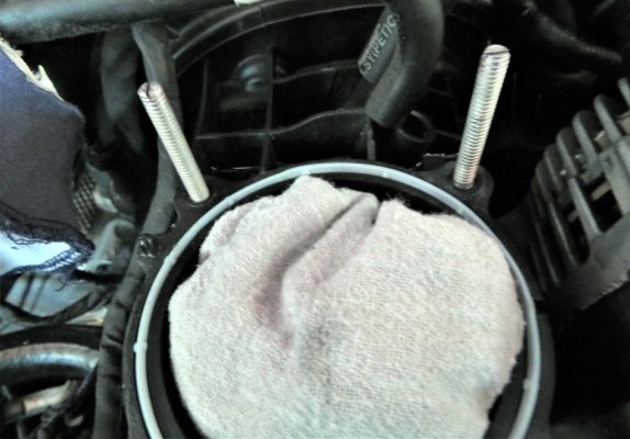

I know nothing about the 3.6,but i have fixed stripped throttle body bolts on the 5.7's composite intake manifold,by making studs.Don't know if you could jury rig a stud fix or not on the 3.6 though.
Sweet idea, I will do that! Did you just glue those studs into the plastic or did you put some countersunk nut on the other side.
Jan 17, 2016
23,874
54,967
14 Sport
I ran a 1/4" tap in the holes and threaded the studs in,lol. Used 1/4" threaded rod/ready rod to make the studs,whether you could use a 1/4" stud i don't know though,as the 5.7's throttle body screw holes will accept a 1/4" tap and stud with-out drilling the holes out. I didn't glue them in,as the studs grabbed pretty good after running a tap into the plastic,but if you're a bit suspicious on them holding you could glue them in
I'm already using larger screws so I will have to use a larger rod, maybe something metric, thread AND glue it in, and drill out the upper intake a little to match the larger stud.
Jan 17, 2016
23,874
54,967
14 Sport
If you want it semi-permanent use JB Weld,but i'd see how whatever you come up with threads in first before gluing it in place.The majority of threaded screws into plastic on a Mopar are 3/16'"or smaller so a 1/4" stud is already a step up in size
