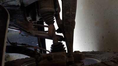

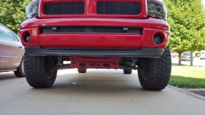

So I have an 04 ram 1500 slt with the 5.7. I got a rough country 5 inch full suspension lift kit installed like 6 months ago and I picked it up today bc my alignment was messed up and the guy said he thinks the lift is messed up. He says he thinks the control arms should be tilted down and rn they're totally level. I also wondered if it was installed wrong bc the front suspension honestly looks like stock height underneath the truck. Yes the truck is taller but it almost looks like just a body lift was down which is not the case. I get a 5 inch isn't crazy tall but I feel like it still looks stock height. Do I have anything to worry about?

The angles look fine to me.. Mine looks comparable to that.. Your control arms shouldn't be at much of a angle cause that's kind of the point of dropping the cross member where your control arms connect to.
